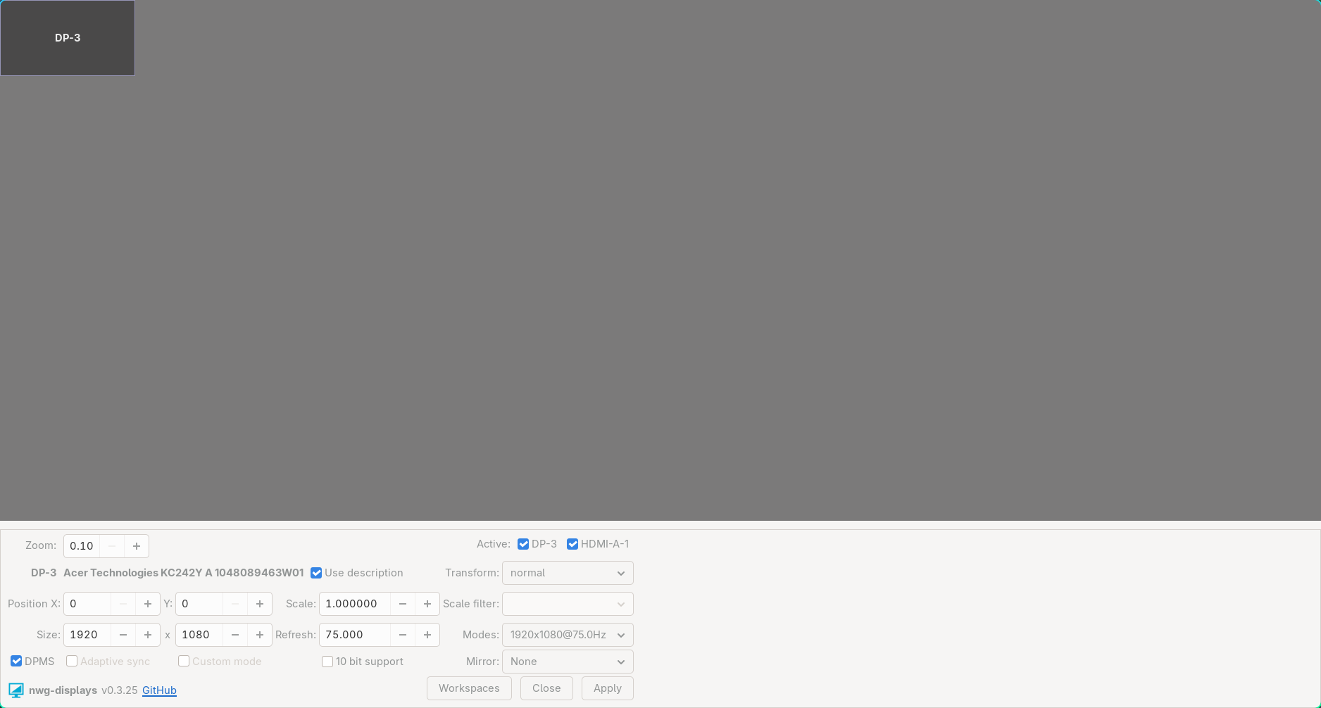

I eventually got it installed by installing nwg-shell. That appears to have changed nothing? I noticed that I now have a program called ‘Display Settings’ on my computer, but when I open it, it only allows me to change the settings for the acer monitor. I’ll upload a screenshot of the program. Also, whenever I try to change the position of the acer monitor, it just resets to zero whenever I click outside of the text box

Not sure what happened, but it appears to be working now. I told the acer monitor to mirror the onn monitor, then told it to stop mirroring the onn monitor, and now the onn monitor is assigned to workspace one, and the acer monitor is assigned to workspace two. I still have that black strip on the left side of the acer monitor though
Much appreciated on both the display software and the linking.
