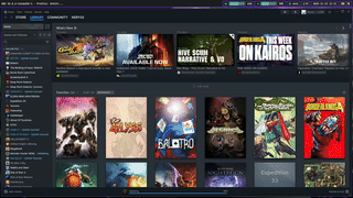

Here’s an example of the issue:
out1
Edit: I’ve tried using v0.52.1-b since I didn’t have this issue last week, however it still happens on this version.
Also I’ve noticed that windows present in hidden workspaces only update when inputs are detected on the same monitor the workspace is hidden in (for example moving the mouse updates the window at the mouse polling rate)

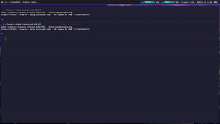

And here’s the same issue with Steam:
out2
