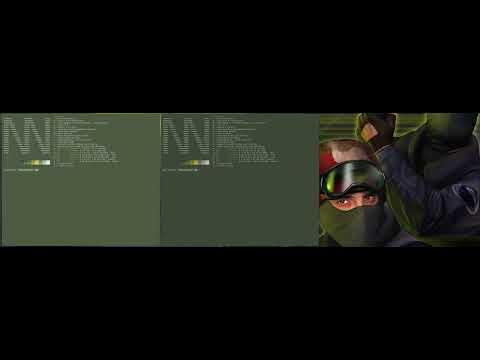

I made a short video to show the bug:
I can’t seem to repro this
Hey, I finally figured out what’s been causing the edge focus issue.
Now, I am not sure who to blame, hyprland or lan-mouse.
I am positive this is on hyprland side tho, as it never happened before when I was using lan-mouse+hyprscrolling.
Basically, I have my laptop configured to be to the left of my main pc in lan-mouse and, regardless of the laptop currently being reachable or not, when I hit the edge where lan-mouse would transfer my input to the laptop, it somehow triggers the refocus on my main pc.
This wasn’t happening with the hyprscrolling plugin, so I would still consider it a regression, but I am not entirely sure to be honest.
I am sorry for the misleading info earlier, I never even thought this could be related to another piece of software.
I’ll try to take a look at the scrolling code, but I highly doubt I’ll be able to figure this one out on my own.
