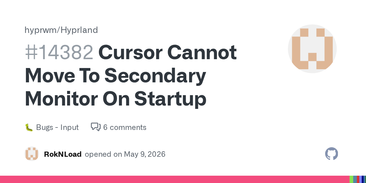

See GitHub Discussion thread:

This appears to be fixed in latest Arch repository,

This was fixed by merged PR:
