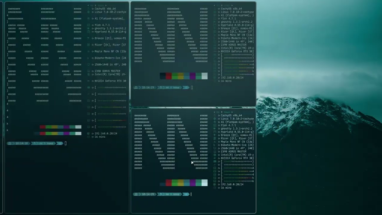

Motion blur has some serious issues with disabled animations and transparent windows.
Disabling animations results in a very low quality, buggy looking motion blur that almost looks like it’s trying to follow the animation that was disabled.
Transparent windows, be it native transparency(ghostty), or opaque < 1(obsidian), result in a lot of flickering.
This does not appear to be related to blur/shadow as disabling either didn’t solve the issue.
Here’s a video that shows both of these issues:

ah yes transparency. There are some alpha issues there, I’ll try to fix them up in the wobble MR as it has the same problem.
Check the wobble branch I pushed some fixes for transparency.
PR does indeed fix the opacity issues I had.
No animations thing is still present, but that’s unrelated and probably expected.
Thanks for such a quick fix!
I actually did some more testing, and there is still a flash with both motion blur and wobble if a window is not opaque.
Like while the effect lasts, the window will be slightly darkened.

I attached the video of it happening in the very first post, you can clearly see the flickering.
