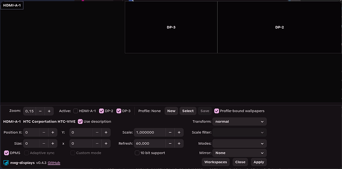

I did notice a strange warning when running nwg-displays though, but didn’t have much luck googling it (cut for brevity):
 nwg-displays
Running on Hyprland
Couldn't assign a Gdk.Monitor to {'active': True, 'modes': [{'width': 2560, 'height': 1440, 'refresh': 99950.0}, {'width': 2560, 'height': 1440, 'refresh': 59950.0}, {'width': 1920, 'height': 1080, 'refresh': 60000.0}, {'width': 1920, 'height': 1080, 'refresh': 59940.0}, {'width': 1920, 'height': 1080, 'refresh': 50000.0}, {'width': 1680, 'hei

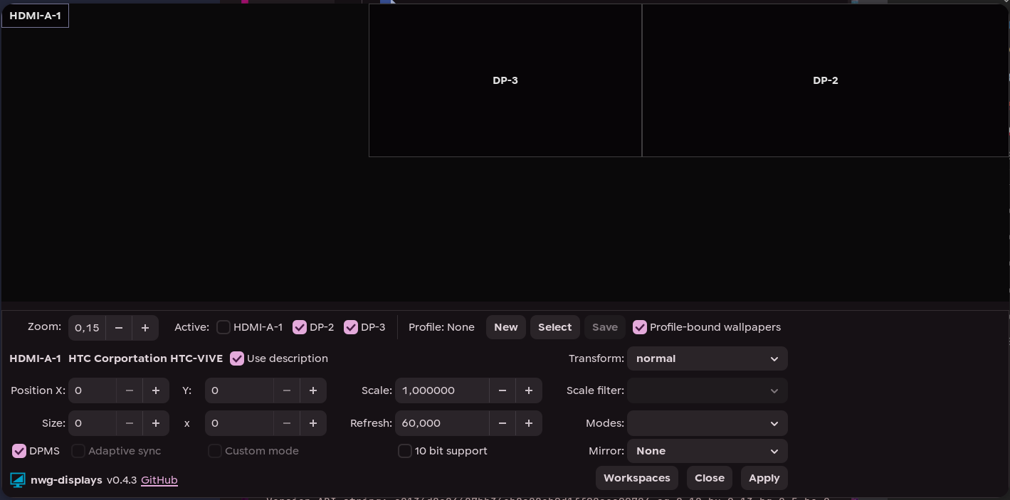

And when I get the UI, the monitors are back in their original position, again not respecting the config files.
I see when I select a monitor here my right monitor flashes the DP-2 tag, no monitor flashes the DP-3 tag, and my main monitor flashes the HDMA-A-1 tag.
Now, what I tried just before posting this was unchecking using description. I activated it again and again I had to go left to reach my right monitor.
The flashing indicating which monitor is which is still borked though.
Hope this helps someone in my position/is a bug that can be looked at.
