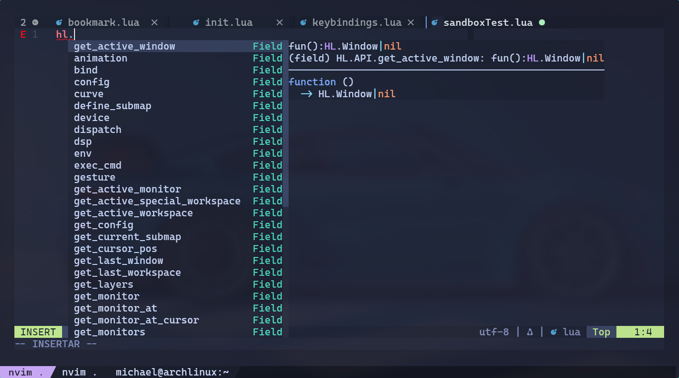

You can probably see the same thing in the terminal with:
cat /usr/share/hypr/stubs/hl.meta.lua | grep "get_active_window"
Also you can change “get_active_window” with whatever you like
For example, is the same
NixOS doesn’t install such a file as part of the package.
it has to, i think in Nix its in /run/current-system/sw/share/hypr/stubs/hl.meta.lua, or similar
