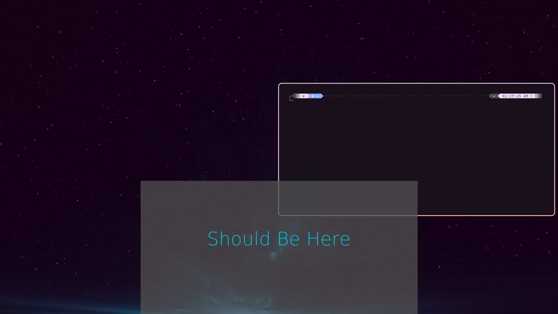

I am having an issue with getting the move windowrule to behave the way I want it to. I am trying to make a floating window spawn on the bottom middle of my screen however it is not really working. I currently have windowrule = move onscreen 50% 100%,class:^(PenTablet)$, but the issue with it is that it is getting centered in relation to the window’s left edge, not the window’s center.
The reason I think that it might be bugged is that I saw on the docs that you should be able to do things like subtracting the window size but when I try things like windowrule = move onscreen 50%-w 100%,class:^(PenTablet)$ nothing really changes.

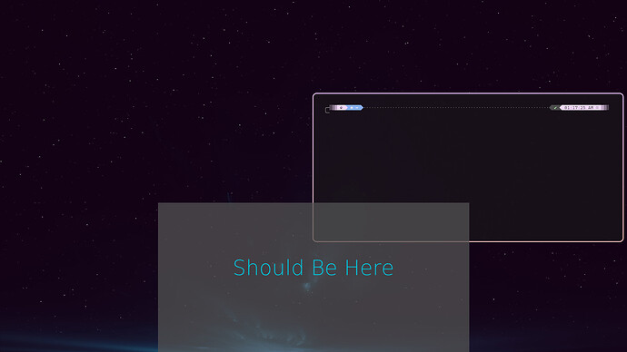

Sorry for not being as clear I could have been. When I said “when I try things like” I meant that I had tried a lot more then I had wrote. In hindsight my example should have been closer to the docs to exemplify my point (I just grabbed what was sitting in my conf at the time for my example).
I tried all of the following however I could not achieve the behavior I was looking for. In fact the following attempts all produced the exact same output. Which, if the docs are to be believed, should not be the case.
windowrule = move onscreen 50%-w- 100%,class:^(PenTablet)$
windowrule = move onscreen 50%-w-20 100%,class:^(PenTablet)$
windowrule = move onscreen 50%-w-20- 100%,class:^(PenTablet)$
windowrule = move onscreen 50%-20 100%,class:^(PenTablet)$
windowrule = move onscreen 50%-20- 100%,class:^(PenTablet)$
I tried a good deal of other things as well but as it has been a day and because these attempts were ultimately unsuccessful I cannot remember all of them.
In conclusion, unless I am fundamentally misunderstanding something about the move window-rule, it would seem to be bugged. If it is not bugged then I think the docs should be revised for clarity.
