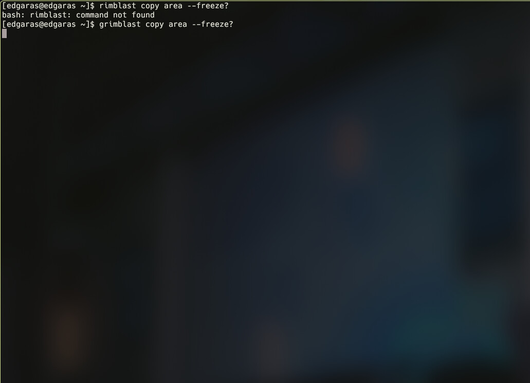

Does anyone else have the reticle cursor show up in the saved screenshot image when using grimblast copy area –-freeze? `

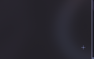

It’s the reticle cursor used to select the area to screenshot, but I feel like it shouldn’t be visible for the screenshot image itself. I haven’t seen anyone else complain about this, so I’m wondering if there is some weird issue with my setup that could be causing it? And it’s not the frozen cursor either, I can make both show up at the same time if I just select the region the frozen cursor is chilling at:

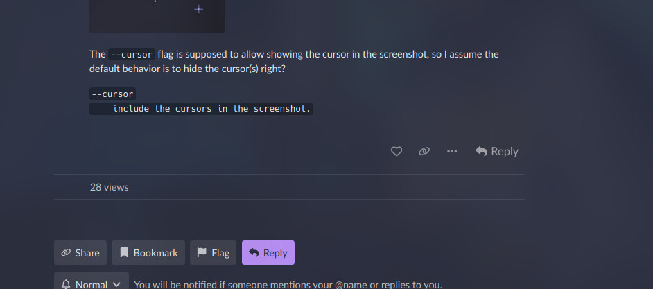

The --cursor flag is supposed to allow showing the cursor in the screenshot, so I assume the default behavior is to hide the cursor(s) right?
--cursor
include the cursors in the screenshot.
