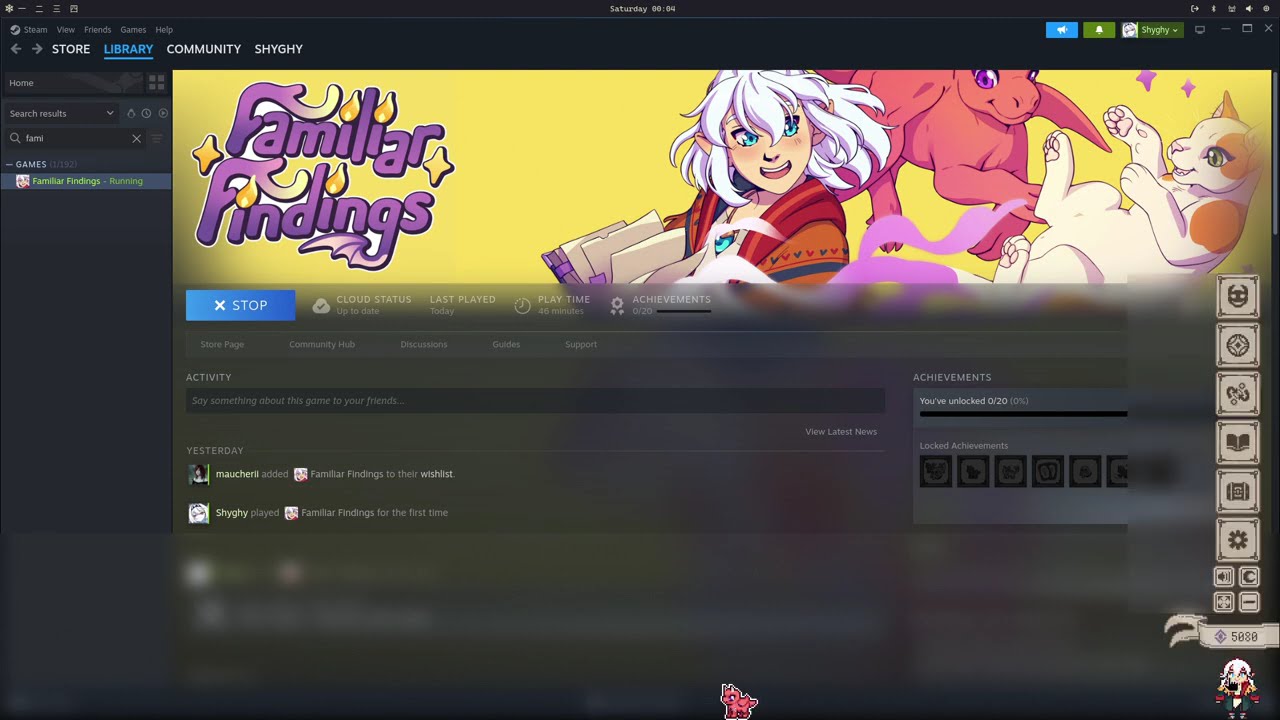

I have a problem refocusing the game ‘Familiar Findings’.
In the video of the link, you can see it works as long as I stay in the window where the game launched. I can click around and can click buttons beneath the game window.
Then I swapped the workspace and the window at once. Afterwards I moved the game to the current workspace with the command hyprctl dispatch movetoworkspacesilent "$WS",class:^Familiar Findings$ ($WS is the identifier of the current workspace) and the game could not regain focus.
So as soon as I swap the workspace or even only the window, which is not solely shown in the video, the game does not refocus. I tried the focuswindow dispatcher but it seems to have no effect.
