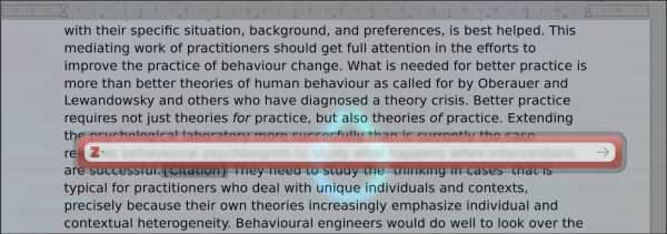

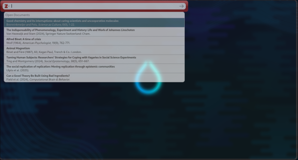

This is the Zotero extension in Libreoffice. Zotero is a reference manager, and with the libreoffice extension you can insert citations into documents. With the text box you search for entries in the collection of references. I’ve tried to upload a picture but I think the file is too big, I’ll try a lower quality picture.
So the one at the top is not maximized, and it shows just the text box floating over the libreoffice document. The one below is maximized via a windowrule, and it shows the list of suggestions, as it should. And the drawback of that method is that the maximized window is too big for the text box and list. Setting the size to 100%, 100%, or any other size, does not do anything.
