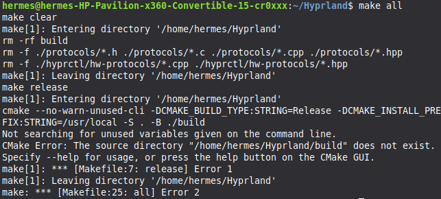

Was just trying to build Hyprland from source, and it’s saying
CMake Error: The source directory "/home/hermes/Hyprland/build" does not exist.
Any idea what I’m supposed to do now? It sounds like the make instructions and the current version of the git aren’t working together

Looking at both the makefile and your error, it looks like make clear is removing build, then make release is failing. maybe try a fresh clone, and then just make release?

Looking inside the make file, I don’t think I see anything for actually making the build directory, right? (I could be wrong, because this is my first time seeing inside a make file)
Screenshot from 2026-08-29 23-16-01
(make all runs make clear and make release in sequence)
