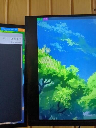

I recently added a second monitor to my hyprland install, and I had some issues getting it set up, but everything except one thing is working fine now. On my right monitor (I’ll call it the acer monitor from here on out), there is a black strip about an inch thick on the left side of the screen. there are borders around the rest of the screen, but for some reason the border on the left side of the acer monitor is way bigger then on any other sides. I uploaded a picture of the left side of the acer monitor.

tbh that sounds like a bad mode, does any other environment work?
If I go into GNOME, it still has that black strip, but it’s applied to both sides of the screen and both monitors. Not sure if that’s what you meant by environment, but hope that helps
that’s odd.. what about sway?
Sway does the same thing as hyprland
might be a driver issue then?
How would I check that? I have an AMD Radeon RX 5500 XT for my GPU. I’m using whatever driver fedora provides
I don’t know, but if all environments have some form of a bar, then either your driver, or your monitor is bust.
Ok. Thanks! I’m pretty sure the monitor is fine seeing as my mom used it for her setup before she gave it to me. I’ll see if I can open an issue with the driver in hopes I can get more help there
