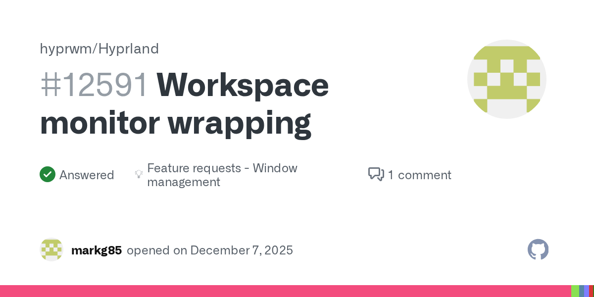

I’m genuinely surprised that I seem to be the only one with this “operational mode” of switching between “monitor-spanning projects” instead of “individual workspaces”!
Edit: Obviously not the only one, as @Ergon pointed out. So I’ll follow up/watch on the relevant github issue: Workspace monitor wrapping · hyprwm/Hyprland · Discussion #12591 · GitHub
