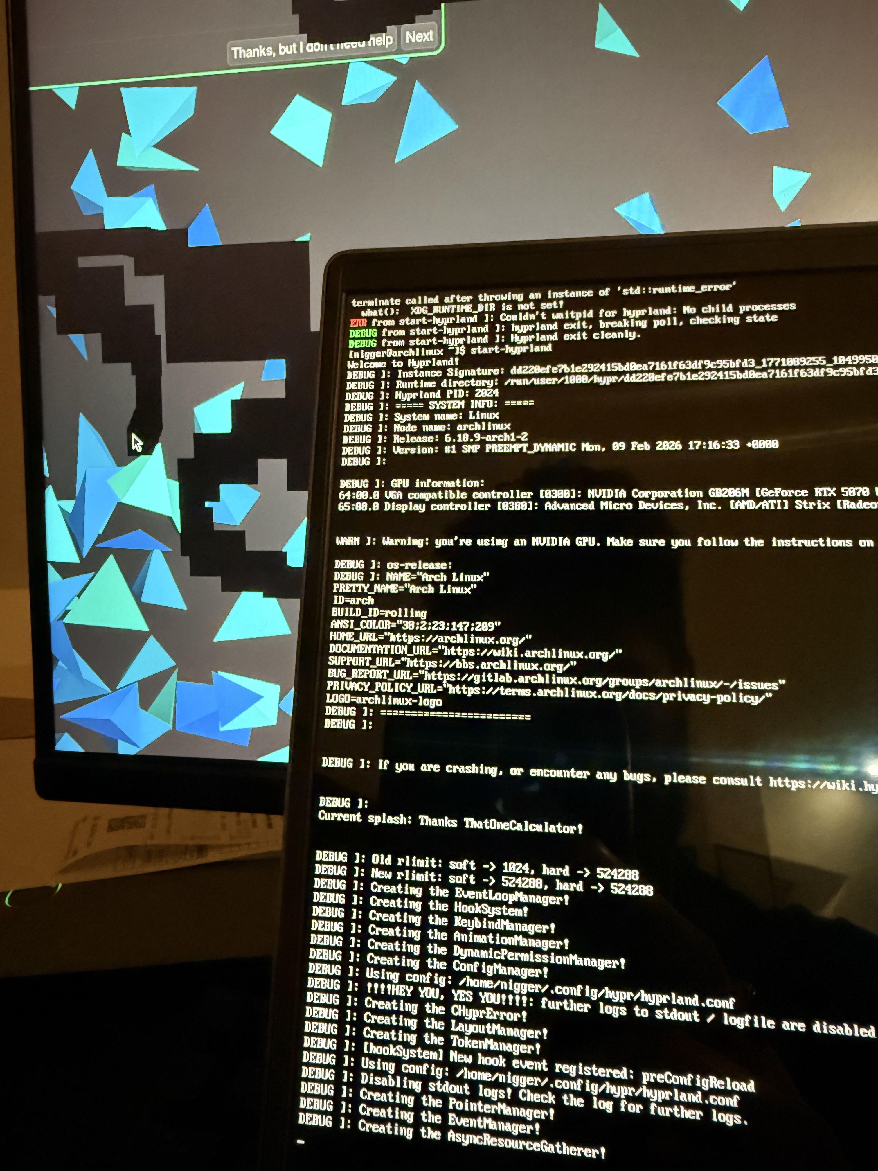

start-hyprland
Nope, I get the below output and can’t quit the process.
start-hyprland
Welcome to Hyprland!
DEBUG ]: Instance Signature: dd220efe7b1e292415bd0ea7161f63df9c95bfd3_1771089178_2129622158
DEBUG ]: Runtime directory: /run/user/1000/hypr/dd220efe7b1e292415bd0ea7161f63df9c95bfd3_1771089178_2129622158
DEBUG ]: Hyprland PID: 1804

I tried running from other laptop through ssh, and it’s the same log output, but with this appened:
terminate called after throwing an instance of 'std::runtime_error'
  what():  CBackend::create() failed!
Hyprland has crashed :( Consult the crash report at /home/user/.cache/hyprland/hyprlandCrashReport1804.txt for more information.

I connected an external monitor to the laptop, and saw this:
