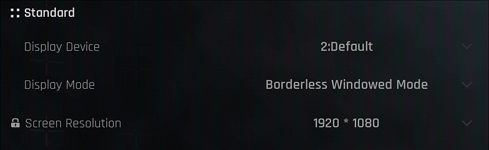

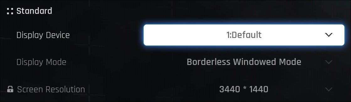

Games sometimes open with the wrong monitor's settings
Once in a while games open on the right monitor but with the settings of the other monitor.
No idea why this happens, maybe related to xwayland or resuming from sleep. I run most games through steam/proton if that matters at all.

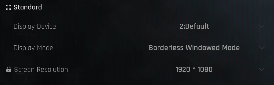

So this happened again today and after running xrandr the primary had disappeared:
The second one is from rerunning xrandr --output DP-3 --primary afterwards.
This seems to happen (sometimes, rarely) when resuming from suspend. Also, all the workspaces got yeeted to the other screen. I’m guessing hyprland is resuming before the second monitor has a chance to come back from suspend.
